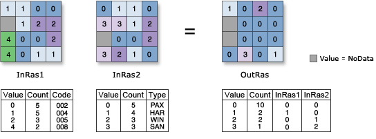

Performs a Combinatorial eXclusive Or operation on the cell values of two input rasters.
If one input value is true (non-zero) and the other false (zero), the output is a different value for each unique combination of input values. If both inputs are true or both are false, the output value is 0.
Learn more about how Combinatorial tools work
Illustration
Combinatorial XOr illustration
OutRas = CombinatorialXOr(InRas1, InRas2)
