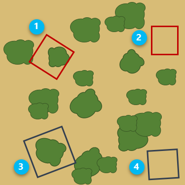

In object detection and classification, a model can predict a positive class or a negative class, and the predictions can be true or false. For example, when detecting the presence of trees in an image, the positive class may be "Tree", while the negative class would be "No Tree". A true prediction occurs when the prediction is correct, and a false prediction occurs when the prediction is incorrect.
In the image below, the red bounding boxes indicate a positive prediction, where the model predicted that there is a tree present. The dark blue bounding boxes indicate a negative prediction, where the model predicted that there is no tree present.
Depiction of true positive, true negative, false positive, and false negative results in a tree detection model
The interpretation of each bounding box is explained in the table below.
Number
Description
True positive—The model predicted that there is a tree, and it is correct.
False positive—The model predicted that there is a tree, and it is incorrect.
False negative—The model predicted that there is no tree, and it is incorrect.
True negative—The model predicted that there is no tree, and it is correct.

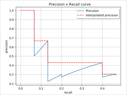

  • Precision-recall curve—This is a plot of precision (y-axis) and recall (x-axis), and it serves as an evaluation of the performance of an object detection model. The model is considered a good predictive model if the precision stays high as the recall increases.
    The precision-recall curve, where interpolated precision is drawn in dashed lines over the true precision
    The precision-recall curve (Padilla et al, 2020) is shown.
  • Average Precision—Average Precision (AP) is the precision averages across all recall values between 0 and 1. AP can be interpreted as finding the area under the precision-recall curve. By interpolating across all points, AP can be interpreted as the area under the curve of the precision-recall curve.
