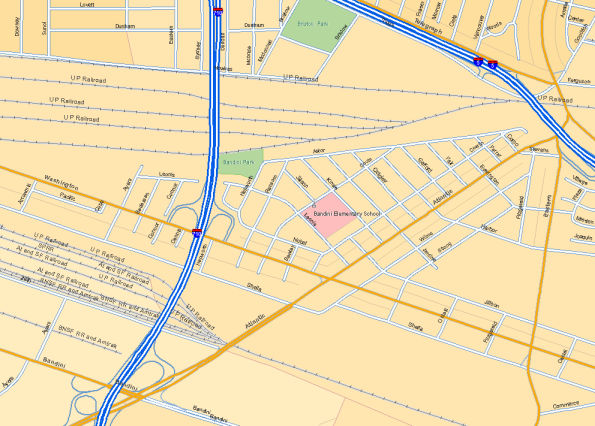

In this example, street data was collected in such a way that line features were not allowed to cross each other without splitting them at their intersections. This caused many streets to be broken up unnecessarily. The map below shows streets, as well as other data that was collected with the streets, such as rail lines and administrative boundaries.
Map of streets and rail lines

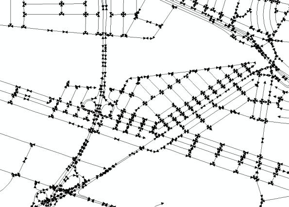

Visualizing the raw street feature class data and rendering the endpoints of the line features with triangles, it is clear there are many breaks in the street features, especially in the areas where the roads cross over the rail lines.
Raw street data showing endpoints at every intersection and, in some cases, along a street segment

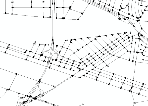

When this data is run through the Dissolve Network tool, the resulting data has fewer street features—150 features, compared to 824 in the original data. Note there are fewer triangles shown in the map below.
The same street data after running the Dissolve Network tool shows fewer endpoints.
This was accomplished by merging line features where there is no difference in attributes between the adjacent features. Note that the endpoints of the lines also no longer need to be present at the street intersections—override connection points (shown here as circles) are created where streets physically intersect, and they are not created where there is no connection. Streets that do meet at endpoints still connect.
