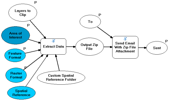

    1. Right-click a copied version of this model and select Edit. ModelBuilder will open and the model will appear similar to the illustration below.
      The Extract Data and Email Task model before editing.
    2. Double-click the Send Email With Zip File Attachment model element to open the tool dialog box.
      1. Enter values for From, Subject, Text, Max File Size, and SMTP Email Server.
      2. Click OK.
    3. You can leave the parameter Layers to Clip and Custom Spatial Reference Folder blank unless you want to provide specific layers or customized spatial reference folder. Leave the parameter to and Sent blank. The parameter Sent is a derived output of Boolean data type, which means it will not show as a parameter when you use the tool. It will set the value automatically when the zip file is sent to the e-mail address you provide.
    4. Save and exit the model.
    5. Run the model tool in ArcMap containing the layers you want to provide to create a result, then publish the result as a geoprocessing service.
