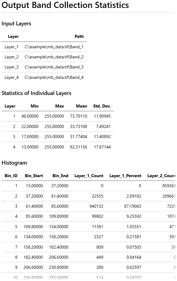

Markdown output after rendering
The following is an example of what the output file in a Markdown format looks like after rendering. This output file is created with the Compute histogram option enabled and the Compute covariance and correlation matrices option disabled.
An example is shown of the output statistics file in a Markdown format after rendering. Only a portion of the fields and rows are shown.
