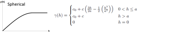

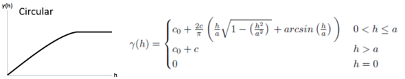

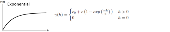

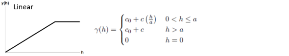

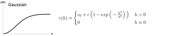

Below are the general shapes and the equations of the mathematical models used to describe the semivariance.
Spherical semivariance model illustration
Circular semivariance model illustration
Exponential semivariance model illustration
Gaussian semivariance model illustration
Linear semivariance model illustration
