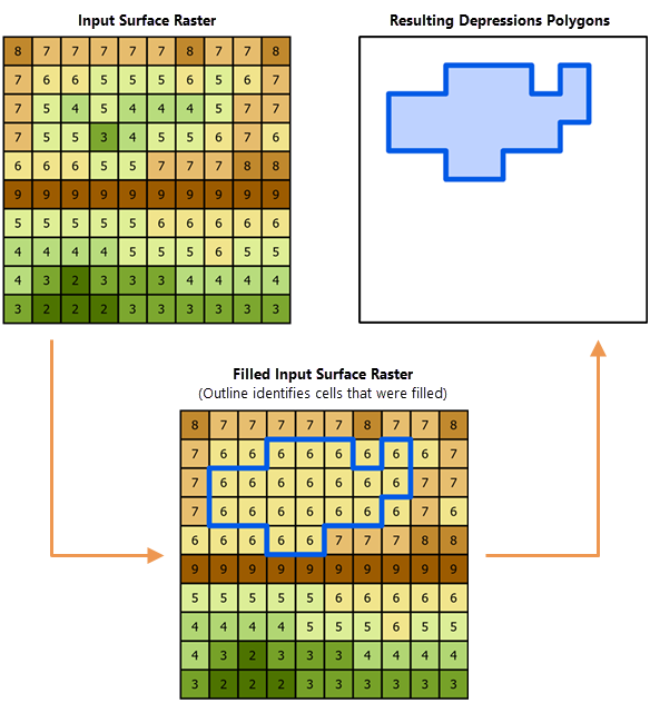

Depressions are found by comparing the original DEM with a filled version of the DEM. The Fill tool is used internally to create the filled version of the DEM. Then, the original DEM is subtracted from the filled version. Cells that change value when the DEM is filled are depression cells. When subtracting the filled DEM from the original, these cells produce values greater than 0.
Input surface raster, filled version, and resulting depression
Figure 1: The relationship between the input surface raster and a filled version of the raster is shown. Subtracting the two is how depressions are initially found.

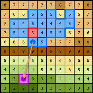

A downstream connection is defined as the closest cell to the edge of a depression that has an elevation lower than the lowest elevation cell within the depression. Depressions with a downstream connection that is farther away than the Maximum Distance to Connection parameter value will be filtered out. The distance is measured from the cell center of a depression edge cell to the cell center of the first found, closest cell with an appropriate elevation value.

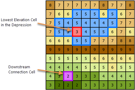

Figure 2 below shows the lowest elevation cell in the example depression found in Figure 1. The elevation value of the lowest elevation cell is 3, so the downstream connection cell must have an elevation of less than 3. The nearest cell with an elevation lower than 3 is the cell with an elevation value of 2. This cell represents the downstream connection location.
Lowest elevation cell and downstream connection for a depression
Figure 2: A depression (in blue), its lowest elevation cell (in red), and its downstream connection location (in purple) are shown.
The distance between the cells highlighted in Figure 2 is measured from the cell center of the closest cell on the edge of the depression to the cell center of the downstream connection. Figure 3 shows an illustration of this distance—in this example, the distance equal to the square root of 17 or about 4.12 cell widths. So, if the Maximum Distance to Connection parameter value was less than 4.12 cells, the depression would not be included in the output.
Distance from a depression to the downstream connection
Figure 3: How the distance from the closest edge cell to the downstream connection is measured.

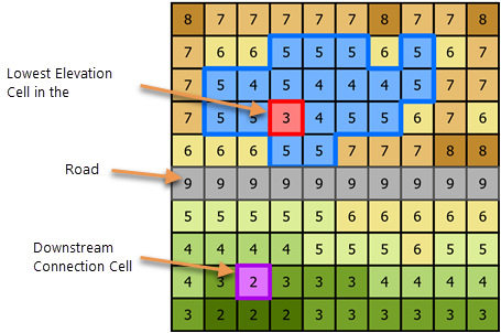

In the depression example from previous figures, a road is located right below the depression. Figure 4 shows the road. The distance from a depression to a road is measured from the cell center of a depression edge cell to the cell center of the road. The resulting distance for this example is 1 cell.
Road shown with lowest elevation and connection for a depression
Figure 4: A depression (in blue), its lowest elevation cell (in red), its downstream connection location (in purple), and input road data (in gray) are shown.
