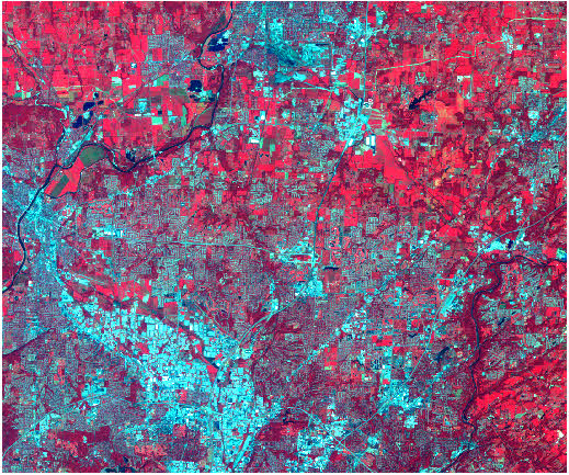

The input multiband raster for the classification is a raw four band Landsat TM satellite image of the northern area of Cincinnati, Ohio.
Input Landsat TM image
Example Landsat TM image, with bands 4, 3, and 2 displayed as a false color image.

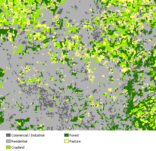

The classified raster appears as shown:
Output classified land use map
Output classified land use map.
An output confidence raster was also created. Below is the resulting attribute table for the confidence raster. It shows the number of cells classified with what amount of confidence. Value 1 has a likelihood of at least 0.995 of being correct. There are 69 cells that were classified with that level of confidence. Value 5 has a likelihood of at least 0.9 but less than 0.995 of being correct. There were 744,128 cells that have a likelihood of less than 0.005 of being correct with a value of 14.
