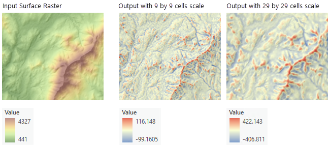

The outputs can be used to interpret features on the input surface raster and their associated spatial scales. The image below shows the results of two different scales for the same surface. One output used a scale of 9 cells by 9 cells, while the other output used a scale of 29 cell by 29 cells. Here, the smaller scale is more sensitive to local variation in the landscape and captures smaller surface features. On the other hand, the larger scale shows less detail by only capturing larger surface features.
Example difference output at two different scales
Maximum difference from the mean elevation at the same extent is shown for two different scales, a small scale (second graphic) and a larger scale (third graphic).
