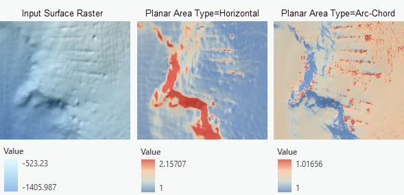

Surface Area Ratio illustration
An example of seafloor terrain and the output rasters for the two planar area types.
An important parameter in the Surface Area Ratio tool is the Planar Area Type. It defines how the surface area of each cell is projected on a plane when calculating the planar area. The parameter has two available options: Horizontal and Arc-Chord.
How the planar area for each cell is calculated
With the Horizontal planar area type, the planar area is the cell’s surface area projected on the horizontal plane, which equals the cell area of the input raster. The tool will output a surface area ratio raster that is dependent on local slopes. It means that, in addition to the roughness of the terrain, the local slope also contributes to the output values. An output value near 1 represents a flat area. Higher values point to areas with higher terrain roughness or steep slopes.
With the Arc-Chord planar area type, the planar area is the cell’s surface area projected on a plane of best fit in a local 3 by 3 neighborhood (Du Preez, 2015). It is calculated by dividing the cell area by the cosine of the local slope. This decouples the effect of the local slope from the output. The output in this case helps understand whether the terrain is flat, or if it has a smooth slope (with values near 1), along with its roughness (with values greater than 1).
