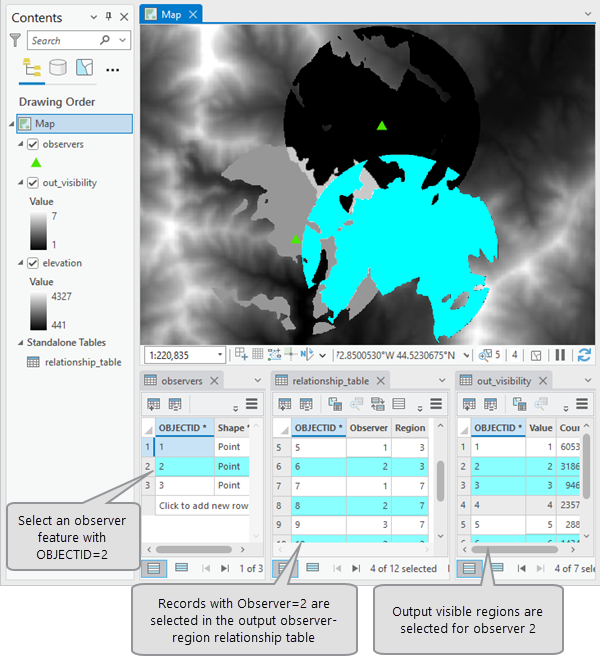

Interactively select viewsheds
Once the relates are established, you can identify the viewshed for any given observer feature by selecting it from the map display or from the feature attribute table. The corresponding visible regions on the output visibility raster will be automatically selected and highlighted in the map display.
The following image is an example of the connection between selections:
Interactively selected viewsheds
