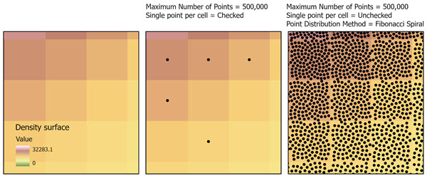

Illustration
Raster to Weighted Points tool illustration
Examples of output points weighted based on density values from an input surface.
