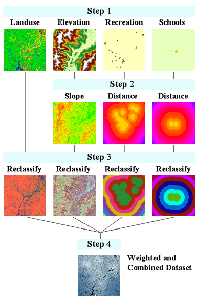

Each of the above examples is considered a suitability model. There are usually four steps in producing a suitability map:
  1. Input datasets.
    Decide which datasets you need as inputs.
  2. Derive datasets.
    When applicable, create the datasets that you can derive from your base input datasets— for example, slope and aspect can be derived from the elevation raster. Create data from existing data to gain new information.
  3. Reclassify or rescale datasets.
    Reclassify each dataset to a common scale (for example, 1 to 10), giving higher values to more suitable attributes.
  4. Weight and combine datasets.
    Weight datasets that should have more influence in the suitability model if necessary, then combine them to find the suitable locations.
Below is a flow diagram of a sample for finding the best locations for a school. The input base layers are land use, elevation, recreation sites, and existing schools. The derived datasets are slope, distance to recreation sites, and distance to existing schools. Each raster is then reclassified on a scale of 1 to 10. The reclassified rasters are added together with distance from recreation sites and other schools having a higher weight.
Example of using reclassification in a Weighted Overlay workflow
