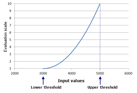

The following graph illustrates how the function values are mapped to the evaluation scale.
Example of transforming the function values from the Power function onto the evaluation scale
The minimum and maximum transformed function values, f(x), are rescaled to the minimum and maximum of the evaluation scale, respectively. Many of the functions are monotonic (continuously increase or decrease). As a result, the lower and upper thresholds will generally map to the minimum and maximum values on the evaluation scale, since they will be the lowest and highest f(x) values.
In the previous example, the lower and upper thresholds are equal to the minimum and maximum of the input data (3,000 and 5,000, respectively). As a result, the lowest input value is assigned a 1 on a 1 to 10 evaluation scale and the maximum input value a 10. However, this does not need to be the case. For example, if the Power function is applied to the same input data (ranging from 3,000 to 5,000), and if the lower threshold is set to 3,500 and the upper threshold to 4,500, then a cell location with an input value of 3,500 will be assigned a 1 on a 1 to 10 output evaluation scale, and the input value of 4,500 will be assigned a 10. All other values will range between the two based on their transformed value. Input values below the lower threshold and above the upper threshold will be assigned to the values you specify.

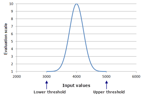

Example of transforming the function values from the Gaussian function on the evaluation scale
Not all functions continuously increase or decrease, however, so the lowest and highest input values may not always map to the lowest and highest evaluation values. By default, in the Gaussian function, the midpoint is the value that determines the highest point of the function (the most preferred value). This is set to the midpoint of your input data. Locations with the minimum and maximum input values will produce the lowest function values, f(x), once the Gaussian function is applied. Therefore, cells with the minimum and maximum input values will be assigned a 1 in the output raster. The midpoint value produces the highest function value, f(x). As a result, cells containing input values equal to this midpoint will be assigned a value of 10 on the output raster.
The Gaussian function might be useful in a suitability model for identifying the best habitat for a rare species of Masdevallia orchid. The orchid is sensitive to elevation. It grows best at an elevations around 4,000 meters. As the elevation increases from there, it quickly becomes too cold for the orchid; as the elevation decreases, it becomes too warm. When rescaling the elevation, the value of 4,000 meters is the most preferred, with other elevations (both higher and lower) being the least preferred.
You can assign any input value below the lower threshold or above the upper threshold to a desired output value (within or outside the evaluation scale or to NoData) using the Value below threshold and Value above threshold parameters. The transformation function will not be applied to these locations.
