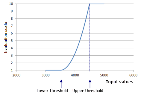

Scenario 2
The defined lower and upper thresholds are within the value range of the input raster. The Power function with an exponent of 2 and a shift of 3500 is used as the example function.
Graph of the Power function curve with the thresholds being set within the minimum and maximum of the input dataset
The value range of the input raster is 3,000 to 5,000. The lower threshold is set to 3,500 and the upper threshold to 4,500. The Value below threshold is set to 1 and the Value above threshold is set to 10. The Power function is applied to input values between 3,500 and 4,500. The range of the function values, f(x), (approximately 0 to 1,000,000) are transformed to the 1 to 10 evaluation scale. The cells with an input value of 3,500 (the Lower threshold) will be assigned to 1 and the input values of 4,500 (the Upper threshold) will be assigned to 10 on the output evaluation scale. All values between the thresholds will be assigned to the appropriate evaluation scale value. Notice the minimum and maximum values from the input raster have no effect on the output evaluation scale values. All cells with an input value below 3,500 are assigned 1 and input values above 4,500 will be assigned 10 (the defined values for the below and above threshold parameters); these values are not considered in the function value range.

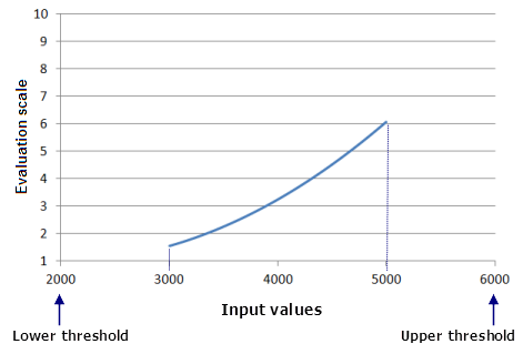

Scenario 3
The lower or upper thresholds are greater than the input data range. The Power function with an exponent of 2 and a shift of 2,000 is used as the example function.
Graph of the Power function curve with the thresholds being set lower than the minimum and higher than the maximum of the input dataset
The range of values of the input raster is 3,000 to 5,000. The Lower threshold is set to 2,000 and the upper threshold to 6,000. The Power function will be applied to the values between 2,000 and 6,000. Even though there are no input values equal to 2,000 or 6,000, the function value, f(x), for 2,000 and 6,000 are used to define the lower and upper range of f(x). The function value range is then rescaled to the 1 to 10 evaluation scale. The function value of 2,000 (the Lower threshold) will be assigned a 1 since it will be the lowest f(x) and the function value of 6,000 (the Upper threshold) will be assigned a 10. However, since there are no input values assigned 2,000 or 6,000, there will be no output cells assigned to 1 or 10.
This scenario might be useful when creating a deer habitat suitability model. You may wish the model to reflect the preference of the deer for the locations within the study area relative to the entire deer population in a larger extent. In the study area, the minimum value for the criterion is 3,000 and the maximum 5,000, but for the larger extent encompassing the entire deer population, the minimum value is 2,000 and the maximum value is 6,000.

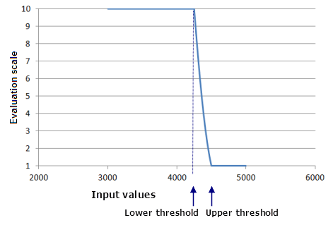

Scenario 5
A special case is scenario 5. The Gaussian function is used with a midpoint of 4,000 and a spread of 0.00000921 as the example function (same as scenario 4).
Graph of the Gaussian function curve with the thresholds being set within the minimum and maximum of the input dataset to the right of the midpoint
The range of values of the input raster is 3,000 to 5,000. The Value below threshold is set to 10 and the Value above threshold is set to 1. The lower and upper thresholds are set to values to one side of the Gaussian function, to 4,250 and 4,500. The default midpoint and the spread, which are set to the altered thresholds, are overwritten by specified values (to the same as in scenario 4). As a result, the specified Gaussian function (which is not constrained between the thresholds) will be applied only to the input values ranging from 4,250 to 4,500. The function value, f(x), range will be rescaled to the 1 to 10 evaluation scale with the Lower threshold (input value 4,250) being assigned to 10 on the evaluation scale and the Upper threshold (input value 4,500) to 1.
