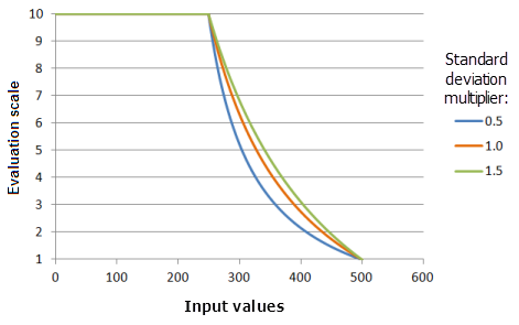

Rescales input data based on the mean and standard deviation where larger values in the input raster have higher preference.

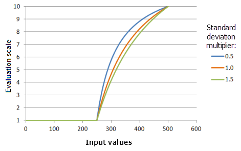

Rescales input data based on the mean and standard deviation where smaller values in the input raster have higher preference.

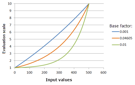

Base factor
The Base factor parameter controls how steeply the exponential function increases. As the base factor increases, the preference for the lower input values increases at a slower rate as the input values get larger and then the preference rapidly increases at the larger input values. Altering this parameter may be useful if your input data range is small (for example, 0 to 1) and you want to maintain an exponential curve between the minimum and maximum values.
Example graphs of the Exponential function, showing the effects of altering the Base Factor value
Example graphs of the Exponential function, showing the effects of altering the Base Factor value.
Function used for the graph above:
  • TfExponential(0.002651, BaseFactor, 0, 1, 500, 10)
    Where the values used for the BaseFactor are: 0.001, 0.04605, and 0.01. The Shift of 0.002651 and the Base factor of 0.04605 are the default calculated parameter values for the input dataset that ranges from 0 to 500.

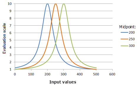

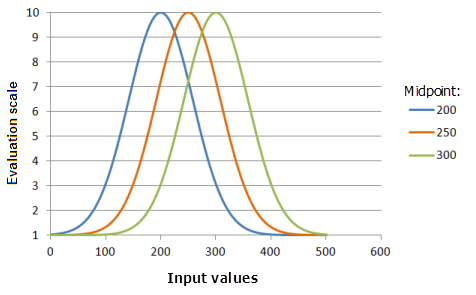

Midpoint
The Midpoint parameter defines the center of the Gaussian curve. You may wish to shift the function midpoint from the data midpoint with either the lower or higher values being more or less important. A second reason you may wish to move the midpoint is to fit the function to values of the criterion outside of the data range.
The midpoint can control the range of the input values the function curve will span.
Example graphs of the Gaussian function, showing the effects of altering the Midpoint value
Example graphs of the Gaussian function, showing the effects of altering the Midpoint value.
  • TfGaussian(Midpoint, 0.000147, 0, 1, 500, 10)
    Where the values used for the Midpoint) are: 200, 250, and 300. The Midpoint of 250 and the Spread of 0.0000147 are the default calculated parameter values for the input dataset that ranges from 0 to 500.

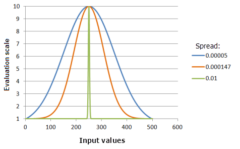

Spread
The Spread parameter controls the steepness of the decay from the midpoint. The greater the value, the narrower the curve becomes around the midpoint (the preference decreases more quickly).
Example graphs of the Gaussian function, showing the effects of altering the Spread value
  • TfGaussian(250, Spread, 0, 1, 500, 10)
    Where the values used for the Spread are: 0.00005, 0.000147, and 0.01. The Midpoint of 250 and the Spread of 0.0000147 are the default calculated parameter values for the input dataset that ranges from 0 to 500.

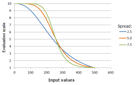

Large function
Overview
The Large transformation function is used when the larger input values are more preferred. The defined midpoint identifies the transition point for the function. Values greater than the midpoint increase in preference and values below the midpoint decrease in preference. How quickly the values will increase and decrease as they move from the midpoint is determined by the Spread shape-controlling parameter.
Use case
To create a commodities trading suitability model, you may want to rescale the coffee yield criterion. Locations with higher yield are more preferred, with the preferences increasing nonlinearly with the yield amount.
Effects of the parameters
Midpoint
The Midpoint parameter defines the transition point of the function. Shifting it to be less than the midpoint value of the input data alters the transition point, resulting in an increase in the range of the larger values being more preferred to the right of the midpoint with the preference increasing at a faster rate.
Example graphs of the Large function, showing the effects of altering the Midpoint value.
  • TfLarge(Midpoint, 5, 0, 1, 500, 10)
    Where the values used for the Midpoint are: 200, 250, and 300. The Midpoint of 250 and the Spread of 5 are the default parameter values for the input dataset that ranges from 0 to 500.
Spread
The Spread parameter controls how quickly the preference increases and decreases. As the spread value increases, input values greater than the midpoint will more quickly increase in preference to the upper threshold, and input values less than the midpoint will more quickly decrease in preference to lower threshold.
Example graphs of the Large function, showing the effects of altering the Spread value
  • TfLarge(250, Spread, 0, 1, 500, 10)
    Where the values used for the Spread are: 2.5, 5.0, and 7.5. The Spread of 5 and Midpoint of 250 are the default parameter values for the input dataset that ranges from 0 to 500.

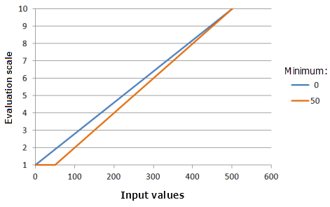

Minimum
The Minimum parameter establishes the first point the Linear function must pass through. You may wish to change the parameter value from the minimum of the input data to correspond to the preference of the phenomenon to the criterion.
Example graphs of the Linear function, showing the effects of altering the Minimum value
Example graphs of the Linear function, showing the effects of altering the Minimum value.
  • TfLinear(Minimum, 500, 0, 1, 500, 10)
    Where the values used for the Minimum are: 0 and 50. The Minimum of 0 and the Maximum of 500 are the default parameter values for the input dataset that ranges from 0 to 500.

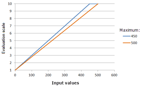

Maximum
The Maximum parameter establishes the second point the Linear function must pass through. You may wish to change the parameter value from the maximum of the input data to correspond to the preference of the phenomenon to the criterion.
Example graphs of the Linear function, showing the effects of altering the Maximum value.
  • TfLinear(0, Maximum, 0, 1, 500, 10)
    Where the values used for the Maximum are: 450 and 500. The Minimum of 0 and the Maximum of 500 are the default parameter values for the input dataset that ranges from 0 to 500.

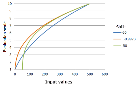

Shift
Shift is the value subtracted from the input values which can control the starting input value for the logarithmic calculations. For example, in the bird use case, if the birds cannot live at locations with less than 250 units of food, you may wish to shift the starting point for the function to 250.
Example graphs of the Logarithm function, showing the effects of altering the Shift value
Example graphs of the Logarithm function, showing the effects of altering the Shift value.
  • TfLogarithm(Shift, 0.0046, 0, 1, 500, 10)
    Where the values used for the Shift are: -50.0, -0.059, and 50.0. The Shift of -0.059 and the Exponent of 0.0046 are the default calculated parameter values for the input dataset that ranges from 0 to 500.

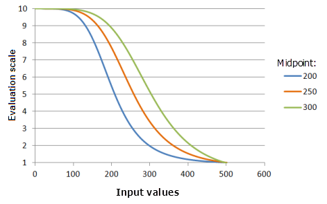

Logistic Decay function
Overview
The Logistic Decay transformation function fits a logistic decay function within a specified minimum and maximum using a defined y intercept percent. In a suitability model, the logistic decay function is best used when the lower input values are more preferred. As the input values increase, the preferences rapidly decrease to a point where the lowest preferences level off at the higher input values.
Use case
To create a housing suitability model, you may want to rescale the distance from electrical lines for the cost of electricity criterion. The locations near existing electrical lines are more preferred because it will cost less to get electricity to them. After a certain distance, the preferences rapidly decrease since additional transformers will need to be installed, incurring additional labor and equipment costs. The decline in preference levels off for the farthest cells since additional cost does not have much additional affect on the preferences since the locations are already too costly.

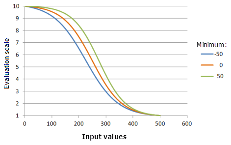

Minimum
The Minimum parameter controls the starting point of the logistic decay. The greater the minimum value, the faster the preferences will decrease in the main decay portion of the function (the curve will be steeper).
Example graphs of the Logistic Decay function, showing the effects of altering the Minimum value
Example graphs of the Logistic Decay function, showing the effects of altering the Minimum value.
  • TfLogisticDecay(Minimum, 500, 99, 0, 1, 500, 10)
    Where the values used for the Minimum are: -50, 0, and 50. The Minimum of 0, the Maximum of 500, and a yInterceptPercent of 99 are the default parameter values for the input dataset that ranges from 0 to 500.

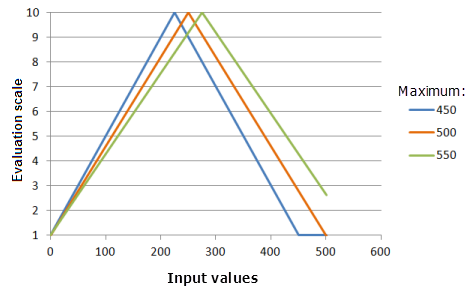

Maximum
The Maximum parameter controls the ending point of the logistic decay. The smaller the maximum value, the faster the preferences will decrease in the main decay portion of the function (the curve will be steeper).
Example graphs of the Logistic Decay function, showing the effects of altering the Maximum value
Example graphs of the Logistic Decay function, showing the effects of altering the Maximum value.
  • TfLogisticDecay(0, Maximum, 99, 0, 1, 500, 10)
    Where the values used for the Maximum are: 450, 500, and 550. The Minimum of 0, the Maximum of 500, and a yInterceptPercent of 99 are the default parameter values for the input dataset that ranges from 0 to 500.

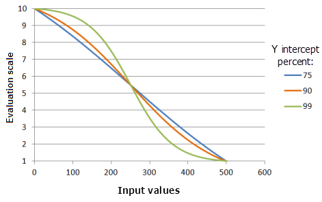

Y intercept percent
The Y intercept percent parameter determines the value range that will be in the decay portion of the Logistic Decay curve. Conceptually think of a logistic decay function as a backward "S" shape. There are two tails connected by the main body of the "S", which will be referred to as the decay portion of the curve. The greater the value for this parameter, the input value range included in the decay portion of the curve will be smaller (the "S" is more upright), however, the preference for the values will decrease at a faster rate and the curve will be more pronounced.
Example graphs of the Logistic Decay function, showing the effects of altering the Y intercept percent value
Example graphs of the Logistic Decay function, showing the effects of altering the Y intercept percent value.
  • TfLogisticDecay(0, 500, YInterceptPercent, 0, 1, 500, 10)
    Where the values used for the Y intercept percent are: 75, 90, and 99. The Minimum of 0, the Maximum of 500, and a yInterceptPercent of 99 are the default parameter values for the input dataset that ranges from 0 to 500.

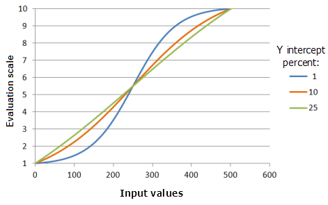

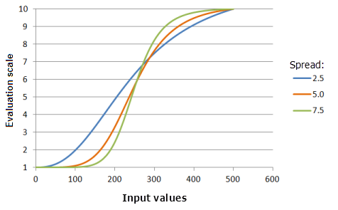

Logistic Growth function
Overview
The Logistic Growth transformation function is similar to the LogisticDecay transformation function, except the preferences in logistic growth function increase instead of decrease.
Use case
In a habitat suitability model, the preferences of an animal increases logistically with the increase in available food. The amount of food first must reach a critical level for survival, then the preference rapidly increases with the increase in food until the maximum intake is reached at which point the preferences level off.

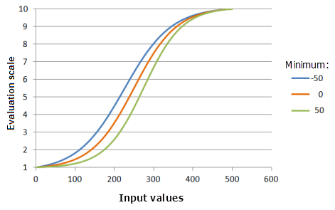

Minimum
The Minimum parameter controls the starting point of the logistic growth. The greater the minimum value, the faster the preferences will increase in the main growth portion of the function (the curve will be steeper).
Example graphs of the Logistic Growth function, showing the effects of altering the Minimum value
Example graphs of the Logistic Growth function, showing the effects of altering the Minimum value.
  • TfLogisticGrowth(Minimum, 500, 1, 0, 1, 500, 10)
    Where the values used for the Minimum are: -50, 0, and 50. The Minimum of 0, the Maximum of 500, and a yInterceptPercent of 1 are the default parameter values for the input dataset that ranges from 0 to 500.
Maximum
The Maximum parameter controls the ending point of the logistic growth. The smaller the maximum value, the faster the preference will increase in the main growth portion of the function (the curve will be steeper).
Example graphs of the Logistic Growth function, showing the effects of altering the Maximum value
Example graphs of the Logistic Growth function, showing the effects of altering the Maximum value.
  • TfLogisticGrowth(0, Maximum, 1, 0, 1, 500, 10)
    Where the values used for the Maximum are: 450, 500, and 550. The Minimum of 0, the Maximum of 500, and a yInterceptPercent of 1 are the default calculated parameter values for the input dataset that ranges from 0 to 500.
Y intercept percent
The Y intercept percent parameter determines the value range that will be in the growth portion of the Logistic Growth curve. Conceptually think of a logistic growth function as a "S" shape. There are two tails connected by the main body of the "S", which will be referred to as the growth portion of the curve. The smaller the yInterceptPercent, the input value range included in the growth portion of the curve will be smaller (the "S" is more upright), however, the preference for the values will increase at a faster rate and the curve will be more pronounced.
Example graphs of the Logistic Growth function, showing the effects of altering the Y intercept percent value
Example graphs of the Logistic Growth function, showing the effects of altering the Y intercept percent value.
  • TfLogisticGrowth(0, 500, YInterceptPercent, 0, 1, 500, 10)
    Where the values used for the Y intercept percent are: 1, 10, and 25. The Minimum of 0, the Maximum of 500, and a yInterceptPercent of 1 are the default parameter values for the input dataset that ranges from 0 to 500.

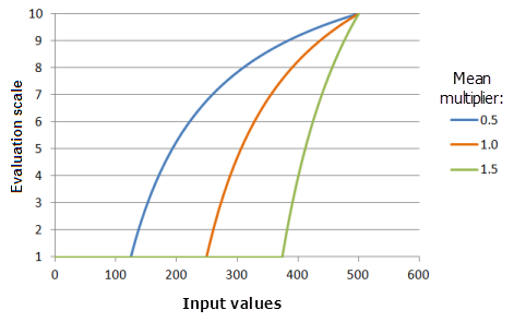

Mean multiplier
Mean multiplier: controls the slope of the curve of the function. As the multiplier increases, the favorable range of the smaller values increases and, with the larger values, the function curve decreases at a faster rate to the upper threshold.
Example graphs of the MSSmall function, showing the effects of altering the Mean multiplier value
Example graphs of the MSSmall function, showing the effects of altering the Mean multiplier value.
  • TfMSSmall(MeanMultiplier, 1, 0, 1, 500, 10)
    Where the values used for the mean are: 0.5, 1.0, and 1.5. The Mean multiplier of 1 and a Standard deviation multiplier of 1 are the default parameter values for the input dataset that ranges from 0 to 500.

Midpoint
Midpoint: the same as the midpoint for the Gaussian function, defines the center of the function curve.
Example graphs of the Near function, showing the effects of altering the Midpoint value
Example graphs of the Near function, showing the effects of altering the Midpoint value.
  • TfNear(Midpoint, 0.000576, 0, 1, 500, 10)
    Where the values used for the Midpoint are: 200, 250, and 300. The Midpoint of 250 and the Spread of 0.000576 are the default calculated parameter values for the input dataset that ranges from 0 to 500.

Shift
The Shift parameter is the value subtracted from the input values which can control the starting input value for the power calculations. For example, in the nuclear power plant use case, it has been determined the plant should not be built within 10 kilometers of the fault line. You may wish to shift the function so that the Power function begins at 10 kilometers.
Example graphs of the Power function, showing the effects of altering the Shift value.
  • TfPower(Shift, 0.3704, 0, 1, 500, 10)
    Where the values used for the Shift are: -50.0, -0.9973, and 50.0. The Shift of -0.9973 and the Exponent of 0.3704 are the default calculated parameter values for the input dataset that ranges from 0 to 500.

Midpoint
Midpoint: defines the transition point of the function. Shifting the midpoint larger than the midpoint of the input data alters the transition point, resulting in an increase in the range of the smaller values being more preferred to the left of the midpoint with the preference increasing at a slower rate.
Example graphs of the Small function, showing the effects of altering the Midpoint value
Example graphs of the Small function, showing the effects of altering the Midpoint value.
  • TfSmall(Midpoint, 5, 0, 1, 500, 10)
Spread
Spread: controls how quickly the preference decreases and increases. As the spread value increases, input values less than the midpoint will more quickly increase in preference to the lower threshold, and input values greater than the midpoint will more quickly decrease in preference to upper threshold
Example graphs of the Small function, showing the effects of altering the Spread value
  • TfSmall(250, Spread, 0, 1, 500, 10)
    Where the values used for the Spread are: 2.5, 5.0, and 7.5. The Midpoint of 250 and the Spread of 5 are the default parameter values for the input dataset that ranges from 0 to 500.
