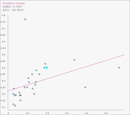

Scatter plot pop-ups
If specified, custom scatter plot pop-ups are generated for each output feature and can be viewed by clicking the feature in the map. The following image shows a scatter plot pop-up for a feature with a positive linear relationship:
Scatter plot pop-up for a positive linear relationship
A scatter plot pop-up for a positive linear relationship is shown.
The rescaled explanatory variable is displayed on the x-axis and the rescaled dependent variable on the y-axis. The single highlighted point in the scatter plot is the feature; all other points are neighbors of the feature.
Hover over a point in the scatter plot to see the Source ID of the feature and the rescaled values of the dependent and explanatory variables along with their raw (original scale) values in parentheses.

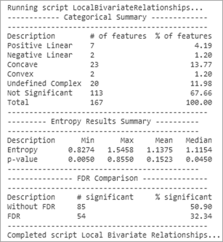

Geoprocessing messages
Summary information about the statistical significance and types of relationships appear as geoprocessing messages. An example of these messages is shown below.
Local Bivariate Relationships messages
The Categorical Summary section of the message lists the number of features and percentages for each relationship type. The Entropy Results Summary section lists the minimum (Min), maximum (Max), average (Mean), and median (Median) of the entropy and p-values of the input features. The FDR Comparison sections lists the number and percent of statistically significant relationships with and without applying a false discover rate correction.
Note:
Geoprocessing messages appear at the bottom of the Geoprocessing pane during tool execution. You can also access the messages using the geoprocessing history by hovering over the progress bar and clicking the pop-out button or expanding the messages section in the Geoprocessing pane.
