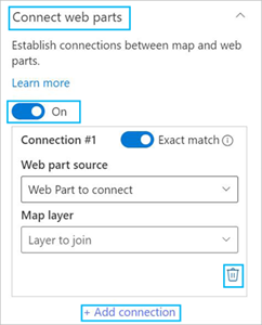

  7. Expand the Connect web parts section.
    The toggle button is turned off by default. Turn it on to activate the Add connection link. You can add up to five connections.
  8. Click Add connection.
    The Exact match toggle button is turned on by default.
    If you turn it off, the query results are filtered to show a fuzzy match.
  9. Choose a connecting web part from the Web part source drop-down menu.
    You can add multiple layers to the map. You can also add multiple lists and web parts from SharePoint. The Web part source drop-down menu reflects the web parts that have been added.
  10. If you connected to a list web part, click the Choose list column drop-down menu and choose a column name.
    The list column is connected to the selected map layer.
  11. Choose a layer to join from the Map layer drop-down menu.
  12. Click Choose layer column and choose a column in the map layer to connect the two web parts.
    The connections are automatically made.
