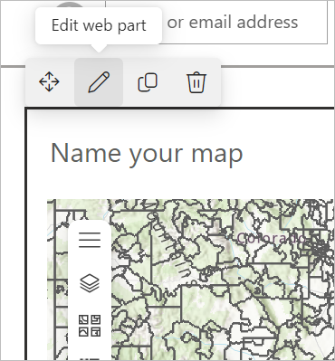

To put the web part in edit mode, first activate edit mode for the published page that contains the map. On the SharePoint ribbon, click Edit web part
In edit mode, you can configure a map and save the configuration as part of the web part. In edit mode, you can do the following:
