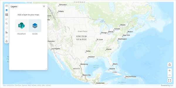

    The map loads with the default basemap and map settings.
    Default basemap and settings
