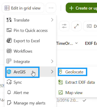

  3. Click ArcGIS.
  4. Click Geolocate.
    Geolocate button on the ArcGIS toolbar

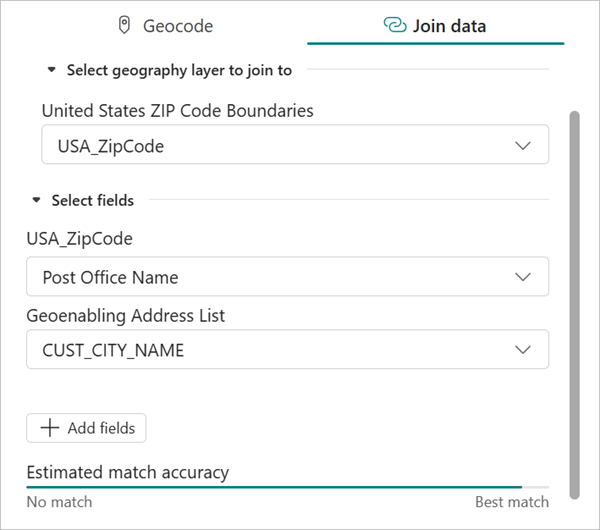

  6. Click the Join data section.
  7. From the drop-down menu, choose an ArcGIS layer.
    Ensure that the layer from ArcGIS contains attributes that match at least one in the SharePoint list or library.
    The layer name appears in the Select geography layer to join to section, and a Select fields section appears and automatically loads possible join fields.
  8. On the drop-down menu below the geography layer, ensure the field you want to use as a match is selected.
    On the drop-down menus in the Select fields section, ensure the fields you want to use from both the layer and the list or library as a match are selected.
    The Estimated match accuracy progress bar updates.
  9. Optionally, click Add fields to add more matching attribute fields.
    Join data in the Geoenable pane

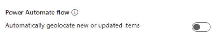

  3. Turn on the Automatically geolocate new or updated items toggle button.
Power Automate flow geolocate toggle
