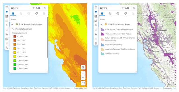

You can synchronize linked map views to use them simultaneously to illustrate a scenario. For example, you can link a map of annual precipitation in the United States with a map of United States flood hazard areas and compare the two maps at the same extent, as shown in the following images:

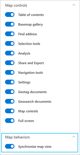

  3. Under Map behaviors, turn on the Synchronize map view toggle button.
    Synchronize map view toggle button in the Map controls section of the ArcGIS pane
    The map view is linked.
