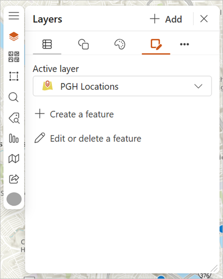

The Editor tool in ArcGIS for SharePoint allows users to create, edit, or delete features on ArcGIS feature layers and in SharePoint lists. This tool is available in both edit and run modes and can be turned on or off by the page author. The tool is enabled as long as you have at least one editable ArcGIS feature layer, an existing SharePoint list, or a new SharePoint list.
Editor tool pane in ArcGIS for SharePoint
To edit ArcGIS layers, you must either be the owner of the feature layer or have Edit privileges in your ArcGIS organization. To edit the feature layer, the Enable editing setting must be enabled on the layer and the Enable editing toggle button must be turned on in Map Viewer. For a SharePoint list or library, users must have edit permissions for the list or library. Layers with edit access are highlighted in the tool; tooltips explain why certain layers are not selectable.

To access the Editor tool, complete the following steps:
  1. Open the SharePoint page with the map.
    If beginning with a blank list, ensure the location type of the layer is configured to store Esri JSON geometry and the type of geometry you want to create.
  2. In the Layers pane, click More options .
  3. Click Editor .
    The Editor pane appears.
  4. From the Active layer drop-down menu, select the feature layer on which you want to create, edit, or delete a feature.
