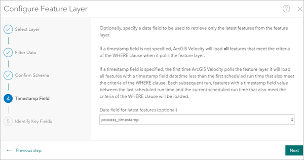

To complement this real-time analytic, a scheduled recurring big data analytic can be configured that uses the output of the real-time analytic as its data source. In this recurring big data analytic, a Feature Layer source is configured to collect the feature layer output created by the real-time analytic. When configuring a Feature Layer source, in the Timestamp Field step, a date field can be selected in the Date field for latest features parameter. Select the date and time field created by the Calculate Field tool in the real-time analytic. In this example, the field name is process_timestamp.
The Feature Layer source uses the timestamp value to retrieve only the latest features from the feature layer on each run. If a field is selected for the Date field for latest features parameter, the first time ArcGIS Velocity polls the feature layer, it will load all features with a timestamp date and time less than the first scheduled run time that also meets the criteria of the WHERE clause. With each subsequent run, features with a timestamp value between the last scheduled run time and the current scheduled run time that also meet the criteria of the WHERE clause will be loaded.
Configuration of timestamp field to specify the
