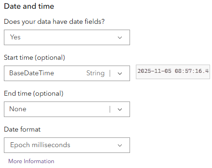

Date format: epoch time
If the data represents dates with epoch time values (also known as Unix time), you do not need to specify a date format. Epoch time is a system for describing a point in time as the number of seconds since 00:00:00 Thursday, 1 January 1970 (UTC). This can be specified as seconds or milliseconds since this point in time. Example values of epoch time that can be processed by Velocity without specifying a date format are 1474675359 or 1474675359000.
Date and time specifying epoch milliseconds
