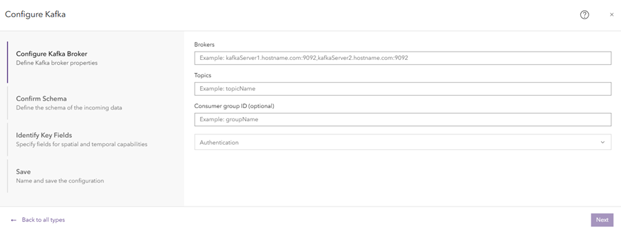

For example, when configuring a Kafka feed, fill in the Brokers and Topics parameters to connect to the data. When configuring an Amazon S3 data source, you must provide all relevant connection parameter values to establish a successful connection.
Kafka configuration parameters
Next, Velocity validates the connection using the configuration parameters provided. Velocity then attempts to sample the data and derive the schema of the data. If the connection is not successful and the schema is not successfully derived, update the configuration parameters accordingly and try again.

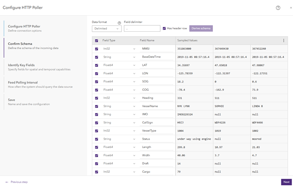

The Confirm Schema step displays the returned schema and a data sample. Depending on the data format, more parameters are available to adjust data parsing to a valid schema.
For this step, you can review and adjust the field names, field types, and data formats. You can also derive the data again to acquire new samples or derive schema after making adjustments to the data format or the data format parameters. This ensures that Velocity can identify the format of the data being ingested by the feed or data source.
HTTP Poller Confirm Schema step

Change field types and field names
Velocity displays field types and field names as identified by schema derivation based on the acquired data sample.
To make adjustments to the derived schema, complete the following steps:
  1. Modify the data format parameters and resample the schema before adjusting the field types and field names.
    If the data format or data format parameters are changed and schema derivation is required, any changes that were made are overwritten.
  2. To change a field type, click the drop-down arrow next to the field name and choose another field type.
    Caution:
    You cannot change field types when using certain feed or data source types such as feature layer feeds or data sources. Use caution when changing the field type. Keep the following in mind:
    • Any field type can be changed to a string type field; however, if you attempt to change a string type field containing letters to an integer type field, an error occurs during data ingestion.
    • Changing fields from a float type (Float32 or Float64) to an integer type (Int32 or Int64) is not recommended. Changing field types is not intended for on-the-fly conversion of numerical values. For some formats, downgrading from a float to an integer can cause the value to be skipped entirely.
  3. Change the field names as necessary.
  4. To unselect a field, uncheck the check box next to the field type.
    The field is ignored when data is ingested from the source. A best practice is to uncheck any unnecessary fields for velocity and volume performance considerations.
