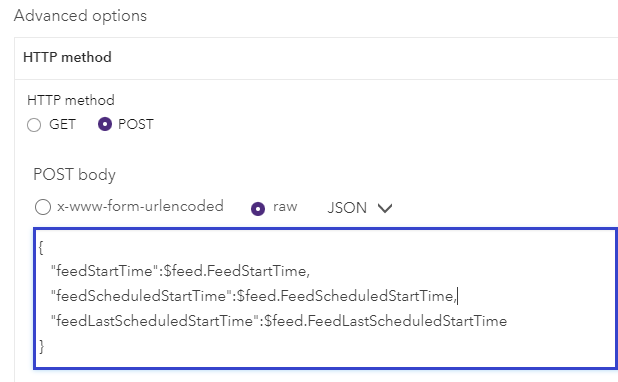

POST body
The message body to be included when sending a POST HTTP request.
This provides a selection between x-www-form-urlencoded and other generic text content types. It also sets the Content-type header.
This parameter only applies when the HTTP method parameter is set to POST.
This parameter supports feed and $accessToken global variables.
