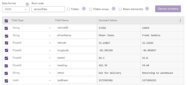

Root node
If applicable, specify the root node of the JSON structure in which messages reside. Leave this blank if the JSON structure contains all the messages in an array at the root level. For example, the following sample JSON shows data with multiple levels and objects:
  "requestInfo": {
    "requestTime": 1573591345,
    "requestingUser": "Greg Smith"
  "responseInfo": {
    "dataLastUpdated": 1573239432
  "sensorData": [{
    "vehicleID": "17256",
    "driverName": "Peter Jones",
    "latitude": 35.21027,
    "longitude": -81.291326,
    "speed": 64.3,
    "heading": 161.34,
    "status": "Out for delivery",
    "lastBreak": 1573591581
    "vehicleID": "11954",
    "driverName": "Frank Jenkins",
    "latitude": 35.23425,
    "longitude": -81.092657,
    "speed": 25.8,
    "heading": 54.64,
    "status": "Returning to warehouse",
    "lastBreak": 1573581253
If a root node of sensorData was specified, only the following data is used in Velocity:
  "speed": 64.3,
  "heading": 161.34,
  "speed": 25.8,
  "heading": 54.64,
The result is the schema derivation below:
Resulting Confirm Schema page with sensorData root node specified

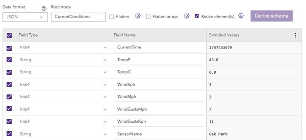

Retain element(s)
The Retain element(s) parameter is available if a root node has been specified. When Retain element(s) is checked, you can specify one or more JSON object names to retain, in addition to the specified root node. These JSON objects should be at the same level as the specified root node. JSON objects identified in the Retain element(s) parameter cannot be flattened.
For example, the following sample JSON contains CurrentConditions and SensorName objects:
  "CurrentConditions": {
    "CurrentTime": 1747433679,
    "TempF":  "43.0",
    "TempC":  "6.0",
    "WindKph":  3,
    "WindMph":  2,
    "WindGustsMph":  7,
    "WindGustsKph":  11
  "SensorName": "Oak Park"
When CurrentConditions is used as the root node and SensorName is used as the Retain element(s) parameter, the result is the schema derivation below:
Resulting Confirm Schema page with Retain element(s) specified

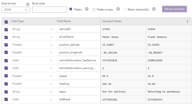

Flatten
The Flatten parameter determines whether nested JSON is divided into separate fields. The new fields are named by appending lower level objects with an underscore to the higher level object. In the example below, the position object contains latitude and longitude objects. When flattened, the position object is divided into two fields, position_latitude and position_longitude.
When flattening, the JSON can be nested with multiple levels of depth. The new flattened field names append object names with an underscore until reaching the deepest level object.
For example, the following sample JSON shows the position and vehicleInformation objects:
  "position": {
  "vehicleInformation": {
    "lastService": 1571431836,
    "warningCodes": 2
  "speed": 64.3,
  "heading": 161.34,
  "position": {
    "lastService": 1560531836,
    "warningCodes": 2
  "speed": 25.8,
  "heading": 54.64,
When the Flatten parameter is checked, the sample JSON above is processed as follows in which the elements in the position and vehicleInformation objects are divided into respective fields:
  "position_latitude": 35.21027,
  "position_longitude": -81.291326,
  "vehicleInformation_lastService": 1571431836,
  "vehicleInformation_warningCodes": 2,
  "speed": 64.3,
  "heading": 161.34,
  "position_latitude": 35.23425,
  "position_longitude": -81.092657,
  "vehicleInformation_lastService": 1560531836,
  "speed": 25.8,
  "heading": 54.64,
The schema is used as illustrated below. While the vehicleInformation_lastService and vehicleInformation_warningCodes field names are cut off by the user interface, they are left intact by the application.
Resulting Confirm Schema page from flattened JSON

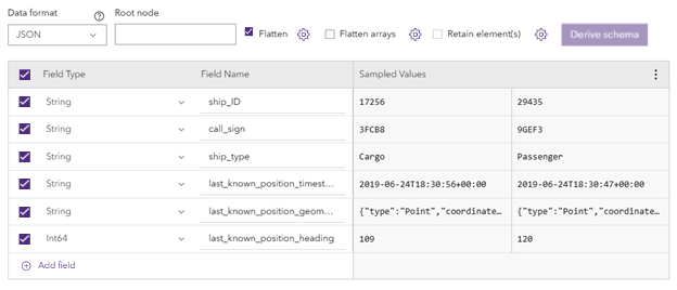

Flattening Exemptions
The Flattening Exemptions parameter allows you to specify one or more JSON element names that are to be left as a single string element instead of divided into separate fields, for example, a JSON object representing an array or an object containing other elements. Consider the following sample JSON:
  "ship_ID": "17256",
  "call_sign": "3FCB8",
  "ship_type": "Cargo",
  "last_known_position": {
    "timestamp": "2019-06-24T18:30:56+00:00",
    "geometry": {
      "type": "Point",
      "coordinates": [
        79.19315,
        7.18374
    "heading": 109
  "ship_ID": "29435",
  "call_sign": "9GEF3",
  "ship_type": "Passenger",
    "timestamp": "2019-06-24T18:30:47+00:00",
    "geometry": {
      "type": "Point",
      "coordinates": [
        73.24954,
        10.43512
    "heading": 120
When the Flatten parameter is checked and a Flattening Exemptions value of geometry is specified, the sample JSON above is treated as illustrated below. In the last_known_position_geometry field, the JSON object has not been divided by flattening because the original geometry JSON element was specified in the Flattening Exemptions parameter. This is useful when you want to retain JSON objects. This is often the case when the geometry object represents the spatial location of features. In this case, the attribute is in the GeoJSON geometry format.
  "ship_ID": "17256",
  "last_known_position_timestamp": "2019-06-24T18:30:56+00:00",
  "last_known_position_geometry": {
    "type": "Point",
    "coordinates": [
      79.19315,
      7.18374
  "last_known_position_heading": 109
  "ship_ID": "29435",
  "last_known_position_timestamp": "2019-06-24T18:30:47+00:00",
    "type": "Point",
    "coordinates": [
      73.24954,
      10.43512
  "last_known_position_heading": 120
The schema is used as illustrated below and the feed or data source location information can be set to be derived from a single field.
Resulting Confirm Schema page from flattened JSON with geometry field exempted from flattening

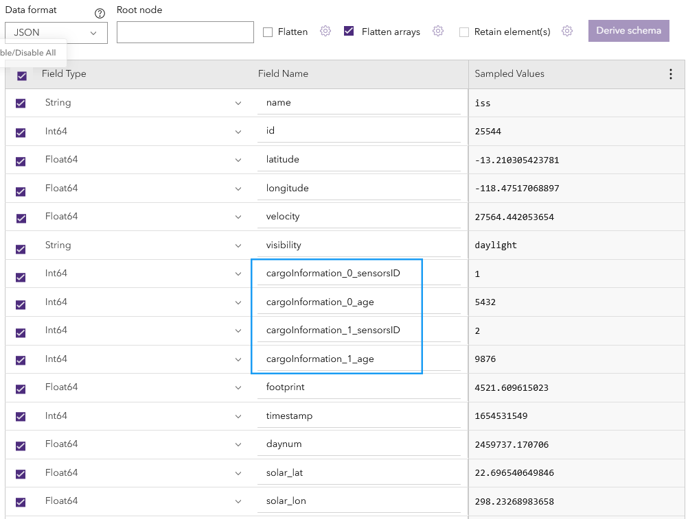

Flatten arrays
The Flatten arrays parameter determines whether arrays are flattened into separate fields. New fields are named by appending arrayName with an underscore and the number of the array object. If the array is an array of objects, the field name also appends an underscore and the name associated with the value. When flattening arrays of objects, the JSON can be nested with multiple levels of depth. The new flattened field names append object names with an underscore until reaching the deepest object.
For example, the following sample JSON shows the cargoInformation array object:
    "name": "iss",
    "id": 25544,
    "latitude": -13.210305423781,
    "longitude": -118.47517068897,
    "velocity": 27564.442053654,
    "visibility": "daylight",
    "cargoInformation": [{
            "sensorsID": 1,
            "age": 5432
            "sensorsID": 2,
            "age": 9876
    "footprint": 4521.609615023,
    "timestamp": 1654531549,
    "daynum": 2459737.170706,
    "solar_lat": 22.696540649846,
    "solar_lon": 298.23268983658,
    "units": "kilometers"
When the Flatten arrays parameter is checked, the sample JSON above is processed as follows in which the elements in the cargo information object are divided into respective fields:
    "name": "iss",
    "id": 25544,
    "cargoInformation_0_sensorsID": 1,
    "cargoInformation_0_age": 5432,
    "cargoInformation_1_sensorsID": 2,
    "cargoInformation_1_age": 9876,
The schema is used as illustrated below. While the cargoInformation field names are cut off in the user interface, they are left intact by the application.
JSON format array flattening

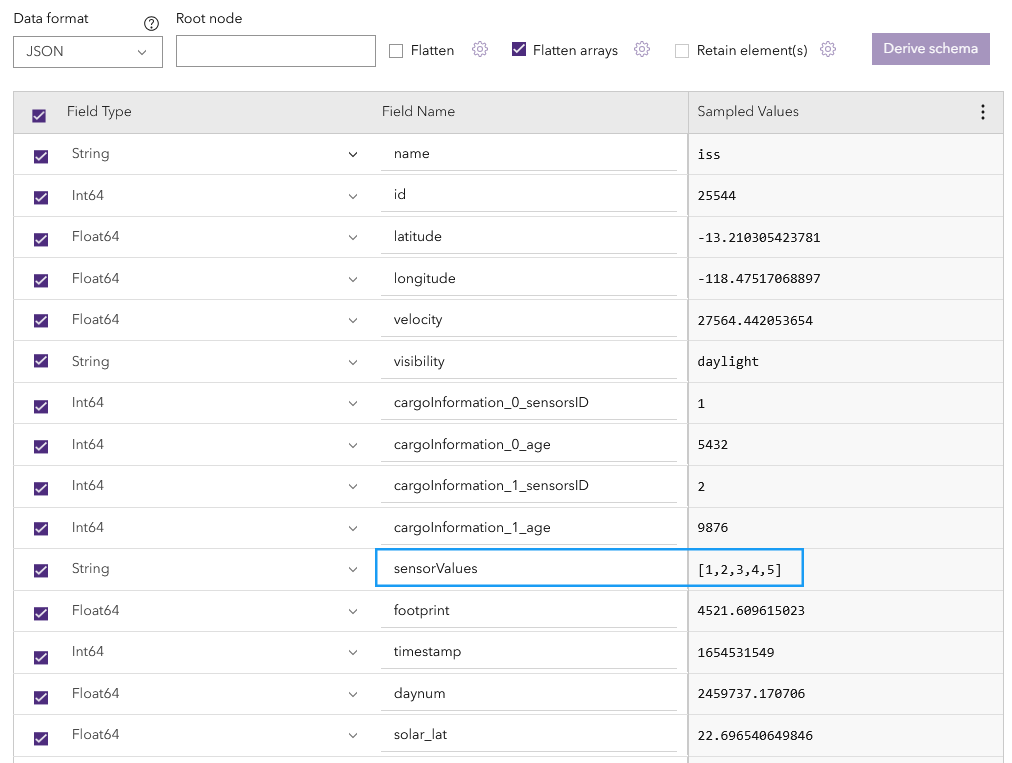

Array flattening exemptions
The Array flattening exemptions parameter allows you to specify one or more JSON array names that are to be left as a single string element instead of divided into separate fields. Consider the following sample JSON:
    "name": "iss",
    "id": 25544,
            "sensorsID": 1,
            "age": 5432
            "sensorsID": 2,
            "age": 9876
    "sensorValues": [1,2,3,4,5],
If the Flatten arrays parameter is checked and an Array flattening exemptions value of sensorValues is specified, the sample JSON above is treated as illustrated below. In the sensorValues array, the array object is not divided by flattening and is left as a string. To indicate that multiple arrays are to be exempted from flattening, separate them with commas in the Array flattening exemptions parameter.
    "name": "iss",
    "id": 25544,
JSON array flattening array exemption
