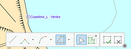

    • If you are creating a geometry for a line feature or a polygon boundary, use the Trace tool to ensure that the reference geometry coincides with the associated line feature.
      Learn more about creating segments by tracing other features
      Construction toolbar with the Trace tool highlighted and Coastline_L feature vertex selected on the map

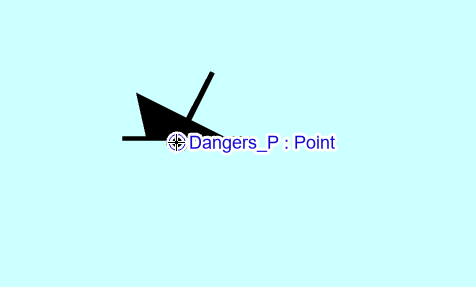

    • If you are creating a geometry for a point feature, turn on snapping and, using the Point tool, click the feature that you want to create an association for.
      Point tool snapped to Dangers_P feature
