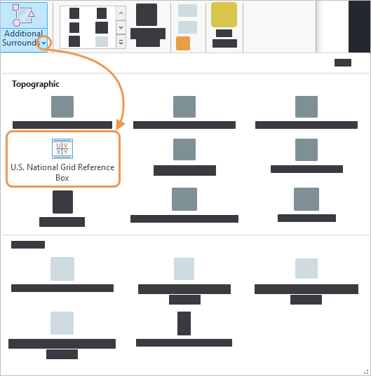

  3. Click the Additional Surrounds drop-down arrow and click U.S. National Grid Reference Box in the Topographic group.
    U.S. National Grid Reference Box element in the Additional Surrounds gallery

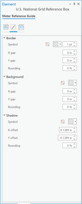

  5. In the Element pane, click the Display tab and configure display options as necessary.
    1. Configure the element's border in the Border section.
    2. Configure the element's background in the Background section.
    3. Configure the element's shadow in the Shadow section.
      Element pane with Display tab active and border, background, and shadow sections expanded

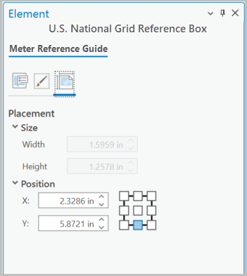

  6. In the Element pane, click the Placement tab and configure element placement options as necessary.
    1. Specify the element's size.
      Resizing is unavailable if the Draw To Specification check box on the Options tab is checked.
    2. Specify the element's position.
      Element pane with Placement tab active and size and position sections expanded
    These settings can also be set from the element's contextual tab in the Size & Position group.
