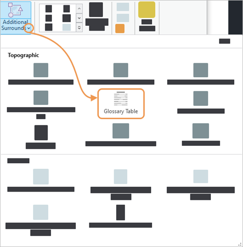

  3. Click the Additional Surrounds drop-down arrow and click Glossary Table in the Topographic group.
    Glossary Table element button in the Additional Surrounds gallery
