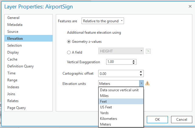

Set the AirportSign elevation units
To set the AirportSign elevation units, complete the following steps:
  1. Double-click the AirportSign feature layer in the Contents pane to open its layer properties.
  2. Click Elevation in the Layer Properties window.
  3. Click the Elevation units drop-down arrow, and choose an elevation unit for the airport signs.
    Layer Properties window for the AirportSign feature layer
  4. Click OK.
