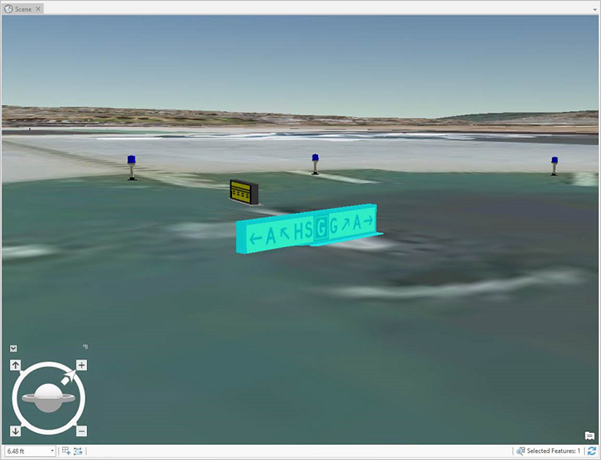

The Manage Signs tool allows you to edit airport signs in a map or scene. This tool allows you to choose the panel style, type the text that is displayed on the sign, and add directional arrows with that text. If editing in a scene, the tool also gives you a 3D preview of what you have configured.

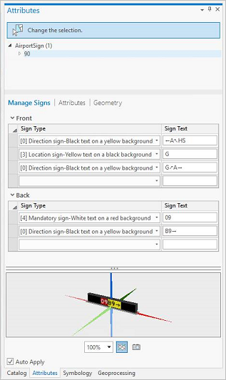

  3. Select an airport sign on the map.
    The feature appears as AirportSign in the upper portion of the Attributes pane. The pane also contains the Manage Signs, Attributes, and Geometry tabs in the lower portion of the pane.
    Airport sign selected from the Attributes pane
    Attributes pane with airport sign selected
    The Manage Signs option is only available when an airport sign is selected. Any other feature selection—for example, an airfield light—makes that option unavailable.
  4. Click the Sign Type drop-down arrows in the Front and Back sections.
    You can provide text values in the Sign Text text box based on the sign type chosen.
    A list of Sign Type options on the Manage Signs tab
    You can also preview the sign based on the procedural symbology.

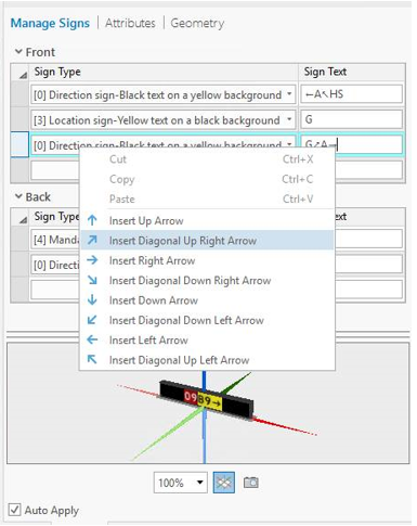

  5. Optionally, add arrows to denote direction for some sign types by right-clicking the Sign Text field.
    A list of direction choices in the Sign Text Field

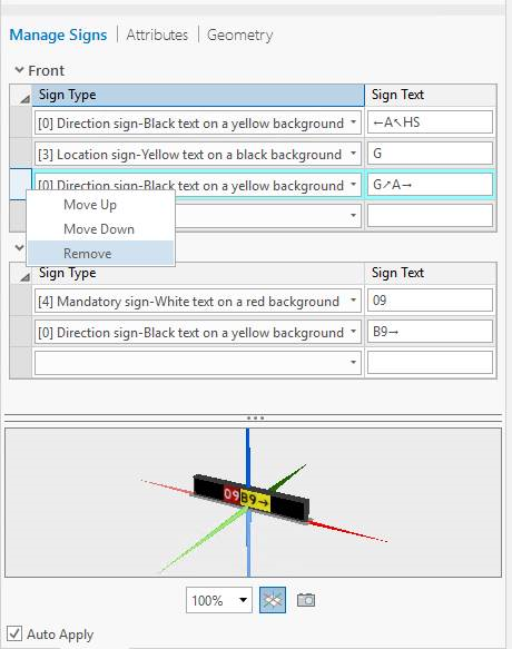

  6. Right-click any of the Sign Type rows to move or remove them.
    Move and Remove row options

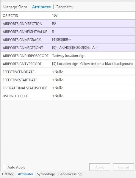

    The following fields are populated on the Attributes tab:
    • AIRPORTSIGNMSGBACK
    • AIRPORTSIGNMSGFRONT
