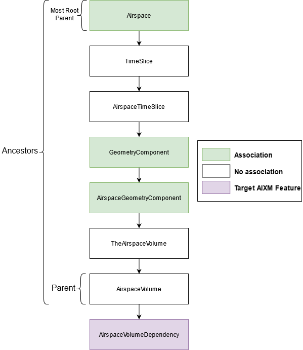

Code sample
The following code sample shows the association between features in the AIXM51SpecConfig.json file:
"airspacevolumedependency": { // The target AIXM feature.
    "relationships": { // All ancestor/child relationships for the target AIXM feature.
      "parent": { // All relationships with an ancestor.
        "/": "identifier",
        "geometrycomponent": "operation",
        "airspacegeometrycomponent": "operationsequence"
    "source_id_field": ".id" // The attribute representing the unique identifier linking the AIS feature back to the source AIXM data.
The code sample above can be visualized in the following diagram:
Association between features in the AIXM51SpecConfig.json file
In this case, the target AIXM feature is airspacevolumedependency. The relationships/parents key defines three ancestor features in the AIXM hierarchy that are included in the AIS geodatabase. Each of these ancestor features is referenced by a unique value in the AIXM feature: identifier for the most root primary object, operation for the geometrycomponent feature, and operationsequence for the airspacegeometrycomponent feature.
Remarque :
Several ancestor AIXM features do not have a specific association with the target AIXM feature. You can create an association between an ancestor AIXM feature and the target AIXM feature with an unused ancestor field by adding a line in the parent key in the AIXM51SpecConfig.json file.
The .id attribute of the target AIXM feature is assigned to the source_id_field key, meaning that the .id attribute is used as the unique identifier linking that AIS feature back to the source AIXM 5.1 message. Typically, this value is used to populate the clientkey_id field in the destination AIS association table.

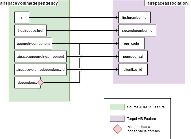

Code sample
The following code sample shows how the AIXM51WriterConfig.json file maps AIXM attributes to features in an AIS geodatabase:
"airspacevolumedependency": { // The source AIXM 5.1 feature.
    "fields": { // The AIXM attributes that will be mapped to fields in the AIS geodatabase.
        "field_name": "firstmember_id"
      "theairspace.href": {
        "field_name": "secondmember_id"
      "geometrycomponent": {
        "field_name": "opr_code"
      "airspacegeometrycomponent": {
        "field_name": "numseq_val"
      "airspacevolumedependency.id": {
        "field_name": "clientkey_id"
      "dependency": {
        "domain": { // A coded value domain for the opr_code field.
          "horz_projection": "sameext"
    "table_name": "airspaceassociation" // The target AIS feature.
The code sample above is visualized in the following diagram:
In this case, the target airspaceassociation feature class in the target AIS geodatabase is populated with attributes from the source AIXM feature. The values /, geometrycomponent, and airspacegeometrycomponent are defined in the AIXM51SpecConfig.json file, so they are included in the source AIXM feature. In addition to the attributes from the AIXM51SpecConfig.json file, a dependency key is defined with a coded value domain. This domain is mapped to the opr_code field in the target AIS geodatabase. Domain mapping is an optional configuration step in which AIXM values are different from AIS values with the same meaning, for example, "no" versus "0" or "BLUE" versus "BLU".
