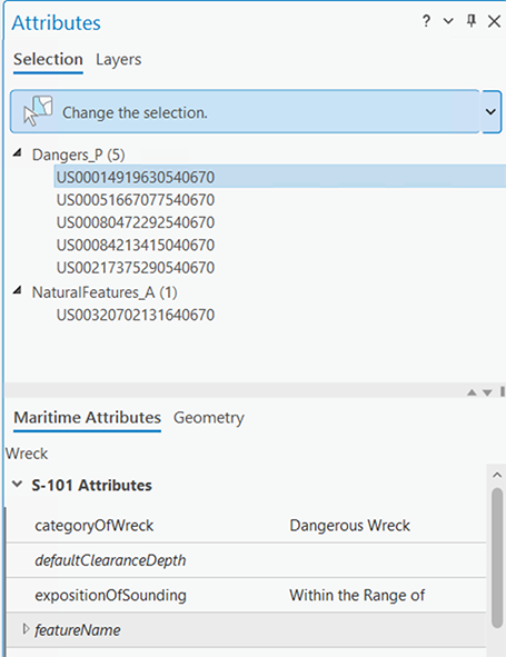

  5. On the Selection tab, click the Select one or more features drop-down arrow to select the features you want to edit, and expand the selection.
    If you selected S-100 features, the Maritime Attributes tab appears in the Attributes pane.
    Maritime Attributes tab in the Attributes pane

  6. Interpret the attribute fields as follows:
    • Regular text—Contains a value.
    • Italics—Empty attributes.
    • Shaded rows—A complex attribute that can be expanded to show the full attribute aggregation.

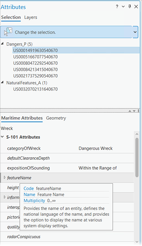

  5. On the Maritime Attributes tab, hover over a field name.
    A tooltip appears with the multiplicity of the attribute.
    Maritime Attributes tab with multiplicity tooltip
    For example, in the image above, the attribute featureName has a multiplicity that allows for 0, or an infinite number of, instances.

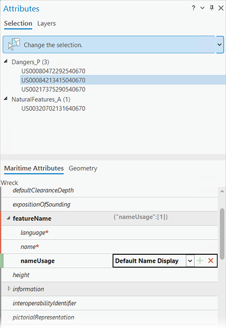

Validation of maritime attributes
The Maritime Attributes tab provides a visual indication of the status of a feature's attributes in the following ways:
  • Green—Required attributes that are valid.
  • Red—Invalid attributes.
  • Bold—The attribute value has been modified since the last time Apply was clicked.
Maritime Attributes tab status visualization
In the image above, nameUsage is set to Default Name Display and is a valid attribute. In the featureName section, the asterisks next to the name and language attributes indicate these values are required for the complex attribute featureName to be valid.
