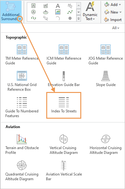

  3. Click the Additional Surrounds drop-down arrow and click Index To Streets in the Topographic group.
    Index To Streets surround element in the Additional Surrounds gallery
