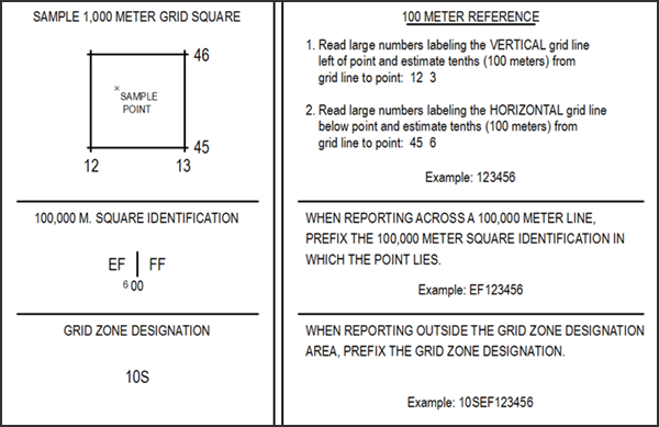

The Meter Reference Guide element provides a set of instructions and examples that allow you to compose standard grid references. It also contains diagrams for identifying the grid zone and grid square designations on the map sheet. This element's properties update based on the associated data frame's coordinate system.
Remarque :
If a grid mask feature class (MSK_<grid_name>) is in the layout view, the Meter Reference Guide element prevents the display of 100,000 M. Square Identification coordinates beyond the area the mask surrounds.
If the map extent appears coincident with an MGRS 100,000 meter-square boundary, the Meter Reference Guide element displays the 100,000 M. Square Identification coordinates on both sides of the boundary.

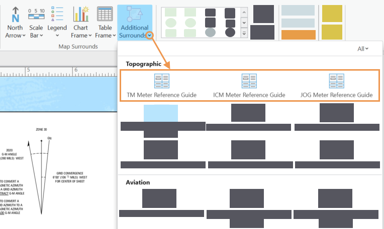

  2. Click the Insert tab.
  3. In the Map Surrounds group, click the Additional Surrounds drop-down arrow and choose a meter reference guide from the Topographic section.
    Meter reference guide elements in the Additional Surrounds gallery
  4. Click an insertion point in the active layout to place the new Meter Reference Guide element.
The Meter Reference Guide is added to the layout and remains selected.

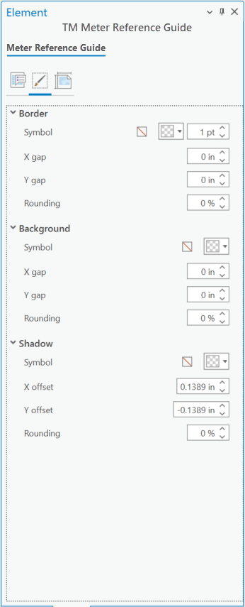

  4. In the Element pane, click the Display tab to set the element's appearance:
    1. Configure the element's border in the Border section.
    2. Configure the element's background in the Background section.
    3. Configure the element's shadow in the Shadow section.
      Element pane for Meter Reference Guide element with the Display tab active

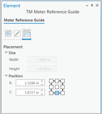

  5. In the Element pane, click the Placement tab to set the element's placement options.
    1. Specify the element's size.
      Resizing is unavailable if the Draw To Specification check box on the Options tab is checked.
    2. Specify the element's position.
      Element pane for Meter Reference Guide element with the Placement tab active
    These settings can also be set from the element's contextual tab in the Size & Position group.
