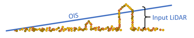

  • The Input LAS Obstacles parameter value is a lidar (LAS) dataset.

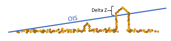

  • A point feature is generated, and output for each lidar point that falls within the area is covered by the OIS, where the height of that point exceeds the height of the OIS feature at that point. The x and y point coordinates are the same as the lidar point with which the output point is associated.
    Delta Z

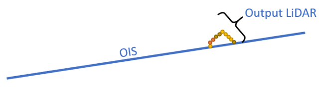

  • When specified to generate the LAS output, the .las file that is generated will contain the lidar points from the input penetrating the OIS surface.
    Delta Z Input Lidar
    Delta Z Output Lidar
