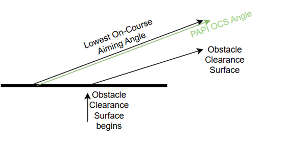

  • The Precision Approach Path Indicator (PAPI) obstacle clearance surface (OCS) angle for all PAPI lights is equal to the lowest on-course aiming angle -1 degree. The PAPI OCS provides the pilot with a minimum approach clearance.
    The following image shows an example of the PAPI OCS angle:
    Diagram of PAPI OCS angle
