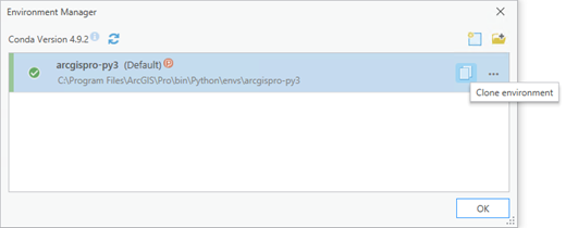

  3. Click the Environment Manager button .
    The Environment Manager dialog box appears.
  4. Click the Clone environment button on the row representing the environment you want to clone.

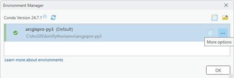

    Alternatively, click the Clone arcgispro-py3 button to clone the default environment, or click the More Options button, and click Clone.
    Clone environment
    The Clone Environment dialog box appears.
  5. Click the Browse button and browse to a folder to store the new environment. Alternatively, click in the Destination text box and edit the default name and path.
  6. Click OK.

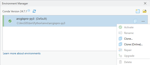

Alternatively, use the Clone (Online) option to clone the environment using internet resources.
  1. On the Environment Manager dialog box, click the More Options button, and click Clone (online).
    Environment more options
    Environment context menu
  2. Click the Browse button and browse to a folder to store the new environment. Alternatively, click in the Destination text box and edit the default name and path.
  3. Click OK.
