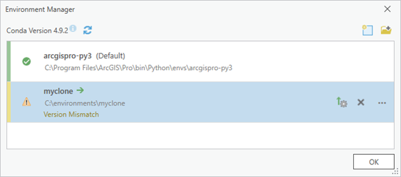

An environment from a previous version of ArcGIS Pro will display a Version Mismatch message on the Environment Manager dialog box.
Version Mismatch
To upgrade one of these environments to the currently installed version of ArcGIS Pro, use the steps in the Upgrade an existing environment section below. Alternatively, an environment can be upgraded from the Python Command Prompt by running the following conda command:

    An environment that needs to be upgraded will be identified by a Warning icon and a Version Mismatch warning message.
  4. Click the Upgrade button on the row representing the environment you want to upgrade.
    Alternatively, right-click the row representing the environment, and select Upgrade.
