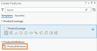

  8. Click the Edit tab and click Create Features .
    The Create Features pane appears.
  9. In the Create Features pane, click the ProductCoverage template.
  10. Create a polygon feature on the active map.

  15. If closed, open the Create Features pane, click the ProductDefinitions table, and click the Forward button to open the Active Template page.
    Create Features pane containing ProductCoverage polygon and ProductDefinitions table

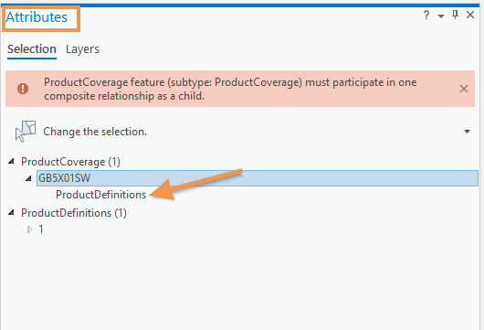

  18. Ensure that the new row and the coverage polygon are selected and open the Attributes pane.
    Both items should appear in the Attributes pane.
    Attributes pane containing ProductCoverage and ProductDefinitions items
    If the coverage polygon is not selected, click Select on the Maritime S-57 tab and select it on the map.
  19. Expand the ProductCoverage node contents until ProductDefinitions appears and right-click it.
    ProductDefinitions in the Attributes pane
  20. Click Add Selected To Relationship.
    Right-click options for ProductDefinitions in the Attributes pane
    The product coverage polygon is linked to the product definition.
