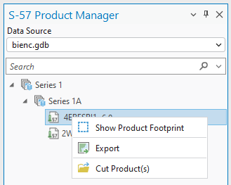

Context menu in the S-57 Product Manager pane

  6. In the S-57 Product Manager pane, right-click the product with the footprint you want to view and click Show Product Footprint.
    The product footprint is added to the Product Footprint group layer and the footprint is shown on the map.
