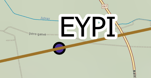

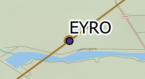

When an ATS route bypasses a navaid or designated point, the route representing the line is curved slightly where the point intersects the route. This does not indicate that the flight path has changed, only that the point is not considered part of the ATS route. The following images show the difference between an ATS route that includes a designated point and a route that bypasses a designated point on a navigational chart:
Add Aviation Line Bypass tool illustration
An ATS route with a line bypass is shown.
An ATS route with no line bypass is shown.
