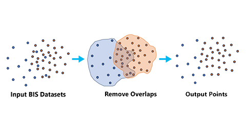

Exports a point or multipoint feature class from input points, multipoints, shapefile points, LAS, or LASD registered to a Bathymetric Information System (BIS). Exported features will comply with filters and ordering provided by an optional input query file, and dataset overlaps can be removed.
図
Overlaps in point data can be removed with the Remove overlaps parameter.

When the Remove overlaps parameter is checked, overlaps will be assessed based on the dataset footprints. Depending on the type of footprint (envelope, convex hull, or precise) and the density of the datasets, unexpected removal may occur, particularly where overlaps encompass large areas. To prevent such removal, manually edit the footprints or use the Replace Footprints tool provided in the ArcGIS Bathymetry product data files to assign custom footprints to datasets in the BIS.

Remove overlaps
(オプション)
Specifies whether overlapping areas across the input point datasets will be exported to the output. In areas of overlap between two or more datasets, only points from the topmost dataset will be exported.
オン—Nonoverlapping point features representing the area where footprints overlapped will be exported.
オフ—Point features will be exported as-is, with all points retained in the output. This is the default.
