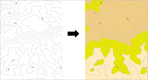

図
Generate Elevation Bands From Features tool illustration
Map imagery before and after elevation bands are generated using the Generate Elevation Bands From Features tool.
