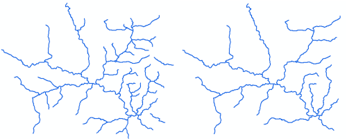

Before and after illustration of the thin hydrology lines process
Stream network before and after using the Thin Hydrology Lines tool
