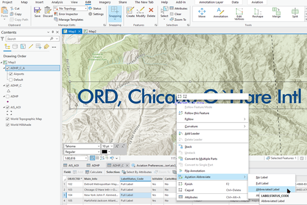

  2. On the Edit tab, in the Tools group, click the Annotation button and select an annotation feature class.
    In this example, an ADHP_C_A Annotation feature is selected . The selected annotation feature is from the Airports annotation class. Its label initially displays ORD, Chicago O` Hare Intl, and it is determined by the custom label expression code defined for Airports.
    Label before Abbreviated Label option selection
  3. Right-click the selected annotation feature class, and from the annotation context menu, choose Aviation Abbreviate , click Abbreviated Label, and choose an abbreviation option from the drop-down menu:

    These abbreviation options are domain values from a coded value domain field in the linked backing feature. In this example the linked backing feature is ADHP_C. The coded value domain attribute field is LABELSTATUS_CODE.
    Примечание:
    Choosing an abbreviation option from this menu causes the label to update based on the chosen abbreviation option. For example, the updated label may be shortened, expanded, hidden, or changed based on custom logic that is preconfigured in the annotation feature class’s annotation class.

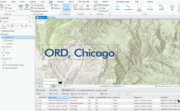

    The annotation class's label expression code is activated and the label output is updated based on custom abbreviation logic associated with the selected Abbreviated Label option.
    For example, the label expression logic for the Abbreviated Label selection changed the label to the airport code followed by the city name: ORD,Chicago.
    Label changed after the Abbreviated Label option was selected

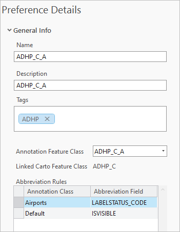

This sample annotation abbreviation preference demonstrates how the annotation classes of an annotation feature class are associated with abbreviation fields from the linked feature class. The Airports annotation class from ADHP_C_A is associated with the LABELSTATUS_CODE abbreviation field from the ADHP_C linked feature class.
Preference Details pane with ADHP_C_A annotation feature class selected
