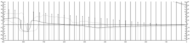

Profile Options tab
Once the Terrain and Obstacle Profile element is visible, further configuration and styling are required to create a finished product. Adjusting the Profile Options settings allows you to create Terrain and Obstacle Profile elements similar to the following examples:
Aerodrome Obstacle Chart profile style
The Aerodrome Obstacle Chart (AOC) profile style is shown.
PATC profile style
The PATC profile style is shown.
You can access the Grid, Runway, and Terrain options to style the element by clicking the Profile Options tab .
Configure the grid properties
