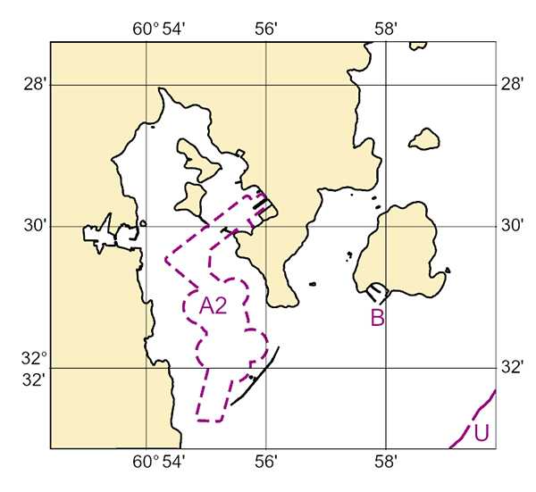

There are two standard ZOC diagram formats: zones defined by outlines with annotation, and color-coded zones without annotation. Examples of these ZOC diagrams are shown below.
Zones of Confidence diagram for a nautical chart
color filled Zones of Confidence diagram
